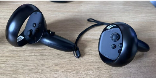

I’m not trying to be a Karen but if I saw someone doing the same thing I’m doing Id say she’s a Karen. When I bought the PCL with the tracking I didn’t know that the Pimax controllers were required to use it so I was trying complete the setup. I suspect I know what is wrong but I can’t say anything because I’d be speculating and could be totally wrong.

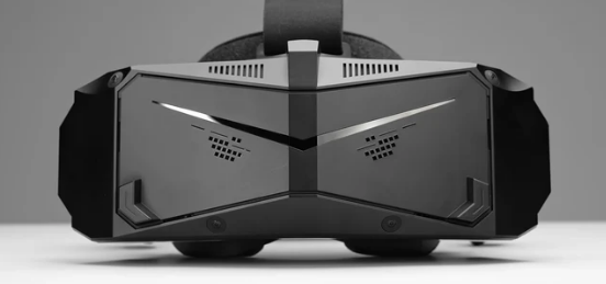

You are correct I bought the headset with the lighthouse face plate because I could have sworn I saw a video that said I could use both the lighthouses and the faceplate. I might have misunderstood it.
I can pair the index controllers to Steam but I have to use the pairing and room setup via Pimax Play. In the pairing, there is no option for any controller other than the Pimax Crystal controller when set to the faceplate. In Pimax there is no longer any option to set height so it’s a crapshoot. Sometimes I’m short, sometimes I’m tall but never really bad.

If you’re using inside-out tracking without controllers, you can set up the room in Pimax Play by calibrating the center and entering the ‘height value.’
Please try reinstalling the Lighthouse faceplate and ensure the tracking mode is set to Lighthouse. The pairing should allow you to pair with the Index controllers.
If it’s still not showing, please take a few screenshots for me.

Do you have the Lighthouse faceplate installed? If so, please switch the tracking mode to Lighthouse.
Next, launch SteamVR, go to the “Devices” tab, select “Pair Controller,” and then press and hold both the System and B buttons on the Index controller for a few seconds to initiate the pairing process.
Alternatively, in Pimax Play, go to “Set Pair,” select “Index,” and then press and hold both the System and B buttons on the Index controller.
Pimax Play does not allow Index controllers. I have to change it to lighthouses in order to do that. What are you trying to get at? I feel like there is a language barrier here.

In Pimax Play there will be an option to switch from inside out to Light house tracking.

I’ve been through those. Thanks for taking the time to share those. The pages mentioned help me to not have to order the pimax controllers. All the more reason to cancel the order and scrap the faceplate to save weight. For a moment let us assume that I do not have any lighthouses. How do I pair the Index controllers to the headset?
If you have no Lighthouses the Index Controllers and other SteamVR tracked items like vive trackers are not usable… They require Lighthouses.
If you had vive tracking puck or Tundra trackers they come with dongles that you can pair them to. But not useable without the lighthouses.
From what I recall I believe there are also other options for watchman SteamVR dongles ie you can flash the steamcontriller Dongle to act as a watchman dongle.
Etee controllers might be able to be used without the SteamVR trackers but might need some extra hybrid setup ie maybe Hand tracking? As they can be used without lighthouses.

My apologies. The Pimax Crystal controllers do not require Lighthouses. They are Tracked by the cameras on the headset. Similar to Quest, Pico & Vive Focus.

The default Crystal headset uses inside-out tracking with the standard faceplate. To pair controllers, you must use the Crystal’s controllers.
If you have the lighthouse faceplate installed on the headset:
You can pair lighthouse-tracked controllers, such as the Valve Index controllers.
