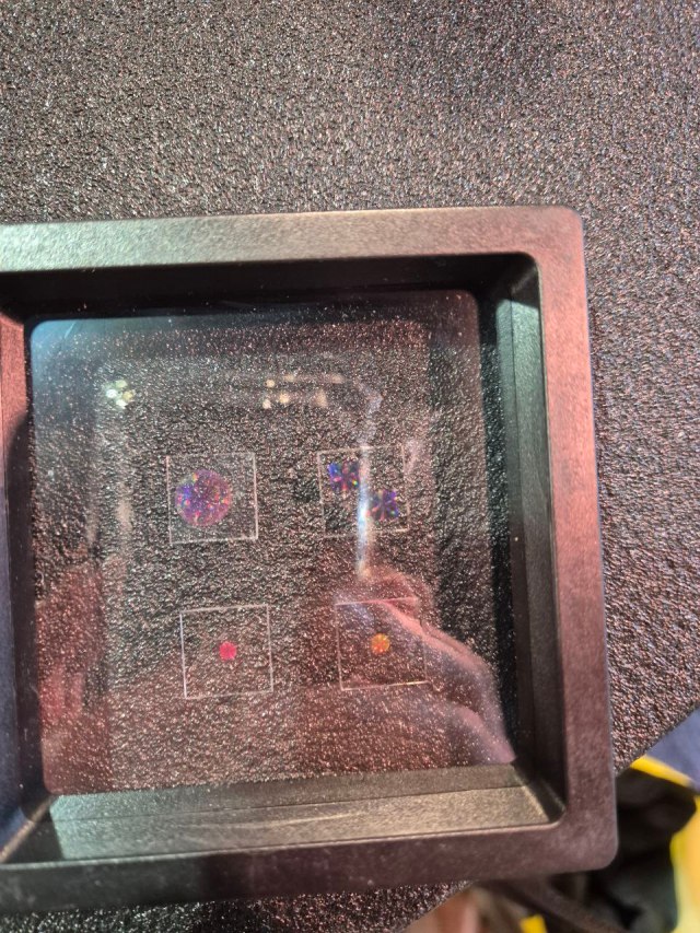

2Pi Optics works exactly on these technologies, and they showed me a few of the lenses they are building. Those four little shapes on the thin film of the picture below are all metalenses.
These four little circles are actually lenses. It is not visible from the picture, but the surface was very thinAnd the one below is a metalens, too, that is installed on a set of binocular cameras.

I knew about metalenses before visiting CES, but seeing them with my own eyes, and seeing how they could be thin and small was impressive to me. I immediately asked the 2Pi OPtics representative if they are building lenses for VR headsets, and he told me that theoretically, this is possible, and they could be able to do that. He said that is rather “easy” to build metalenses for VR, while AR, considering the different nature of the visual engines needed by augmented reality, would be much more tricky.
He also said anyway that building VR lenses with metasurfaces would be not cost-effective today. This means that it would make the price of a headset grow so much, that is not convenient to use metasurfaces and that’s why all manufacturers are still using standard optical lenses. But he said that in the future, this could become viable. And this made me dream about how XR headsets could become thanks to them.
