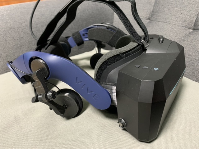

4. HTC Vive DAS Adapter Mods
This is a Collection of DAS adapters & Mods for using with PimaxVR headsets. They can likely be adapted for use with other VR HMDs.

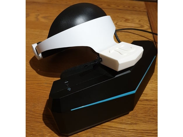

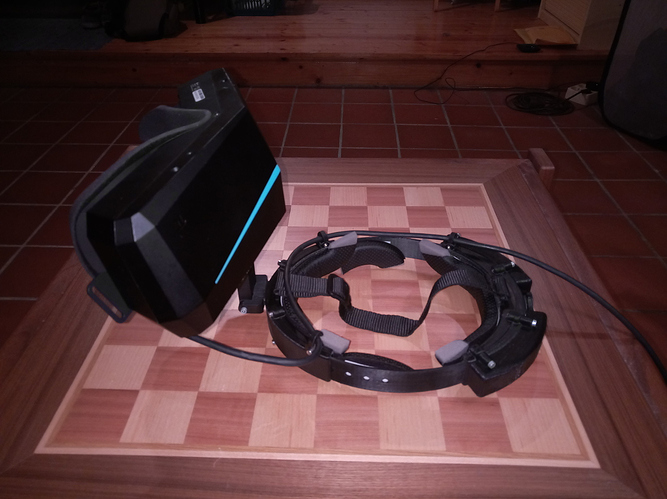

1. Menithal * Top Clip & Hinges - Oct 2018
Originally Made for the Pimax 5K+/8K Headset using measurements from @UnholyBeardedOne at Pimax Forums, and ‘image-reverse engineered’ from video stills frommixedrealityTVandSweViver. Not all measurements are done with a caliper.
This Refined version is improved upon using materials that come with the Pimax.
Pimax 5/8K - Vive Deluxe Audio Strap Adapter V2 (Tested) by Menithal - Thingiverse

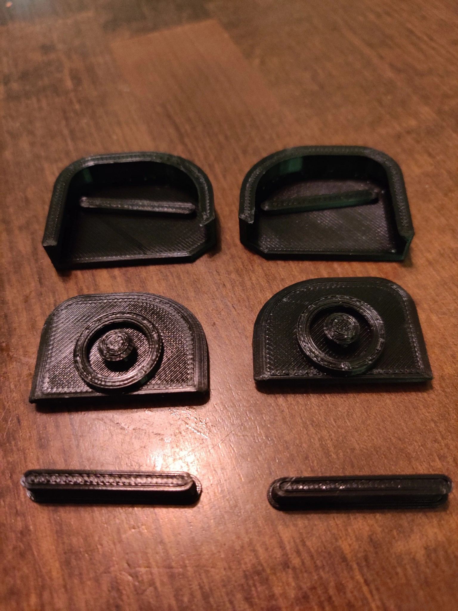

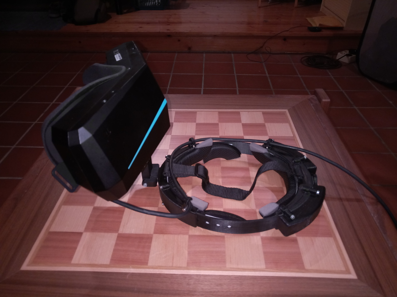

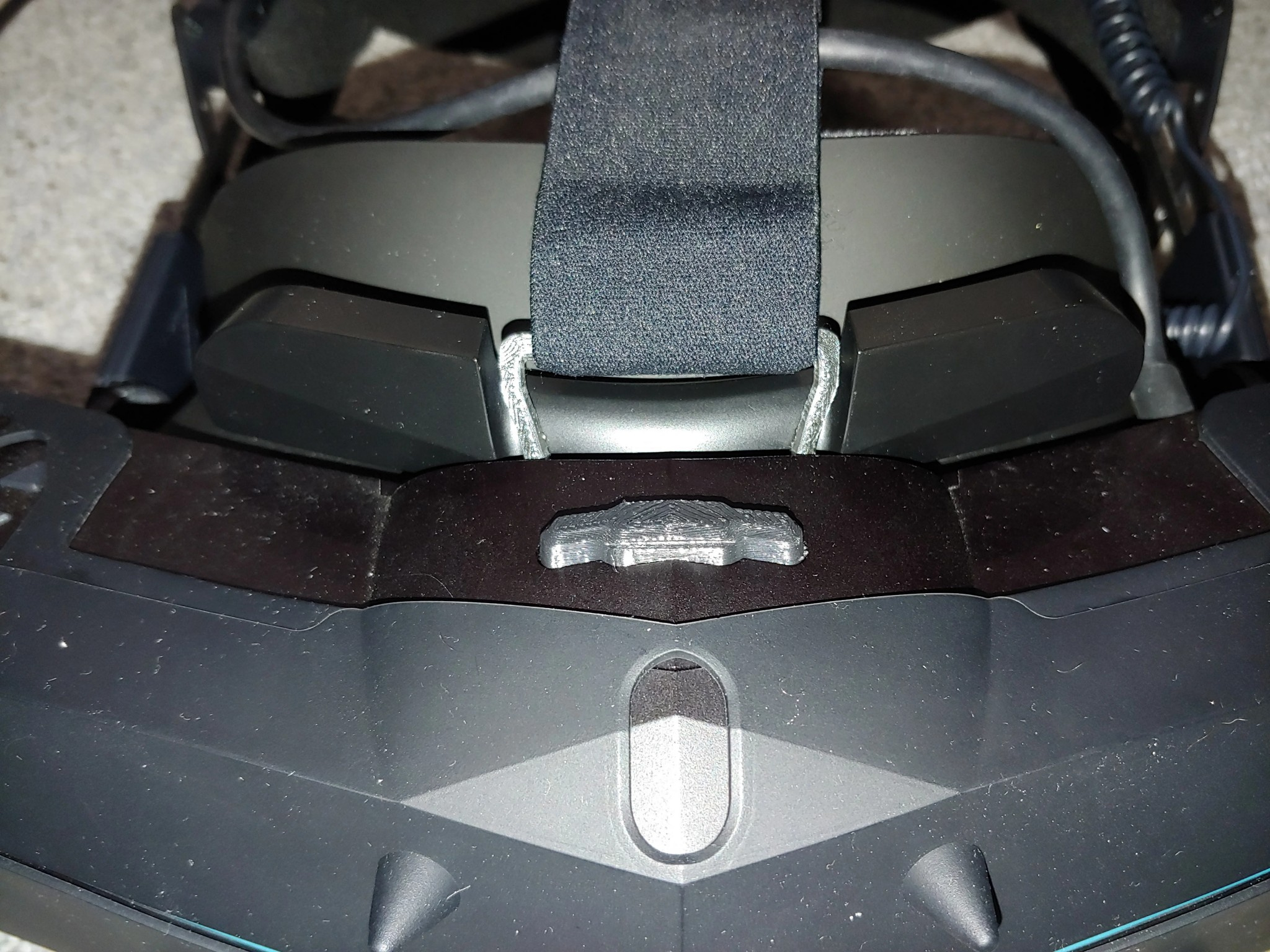

2. DrCube * Top Clip & Hinges - Dec 2018
Hinges and clip to allow you use your Vive DAS with your pimax 5k or 8k. There is a shorter and longer version of the side hinges depending on the size of your head. No supports required for top clip
Pimax + Vive DAS Adapter by Drcube - Thingiverse
A) Tighter Fit Hinge Adapter
Apr 2020
By: Spdqbr
After printing the most excellent “Pimax + Vive DAS Adapter” by Drcube, I had trouble getting a tight enough fit for more vigorous games. This part simply takes the “DAS_Adapter_Short_Sideways_Printable_A” part and moves the pimax attachment point in, to give about an extra inch of tightenting room.
You will still need the rest of the parts fromDrcube’s adapter
Vive DAS to Pimax Adapter - Tighter fit by Spdqbr - Thingiverse

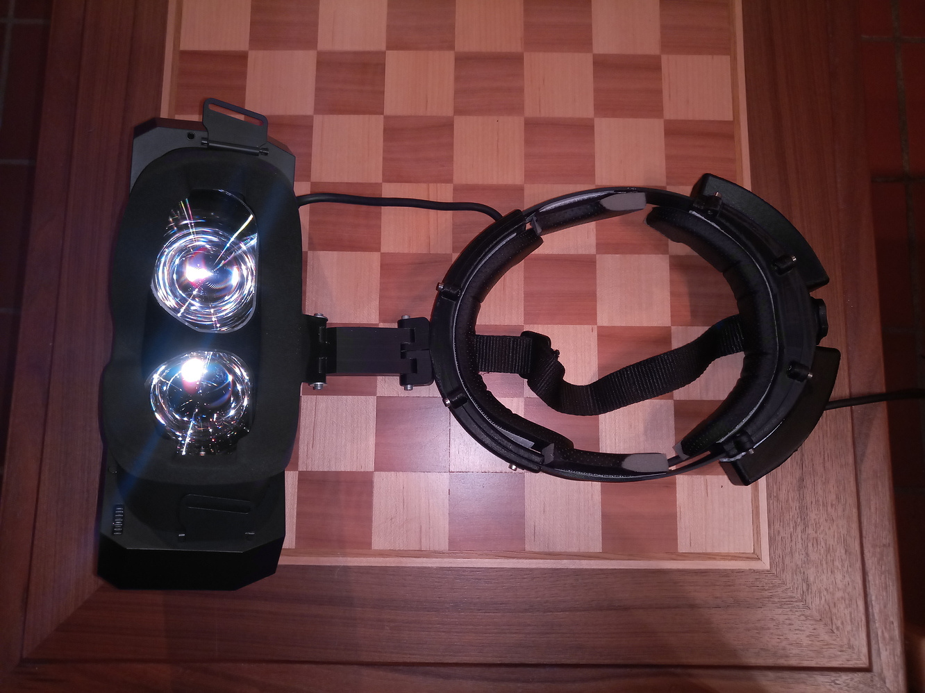

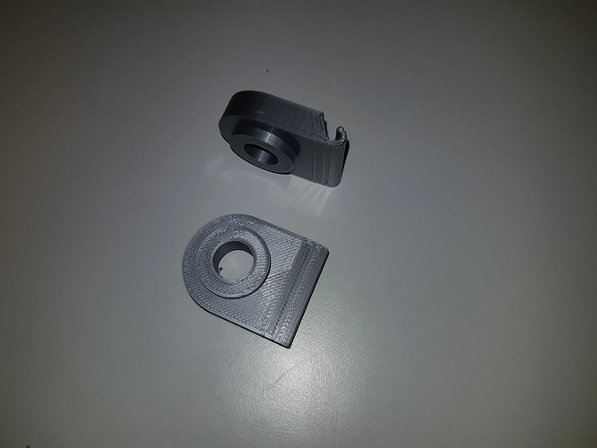

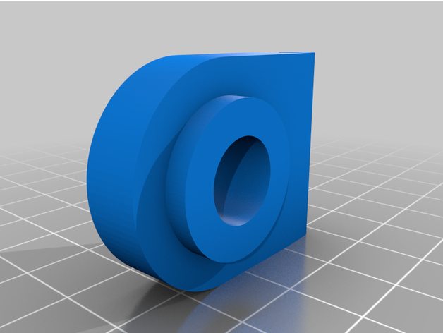

3. g_code3d * Slide Over Hinges - Feb 2019
Pic Version v2
This is a remix of DrCube’s Pimax + Vive DAS Adapter(used DAS peg portion), but instead of removing the Pimax hinges, these pieces slide over the hinges and use the strap loop as a locking pin cutout.
Pimax+Vive DAS Slide Over Hinges by g_code3D - Thingiverse

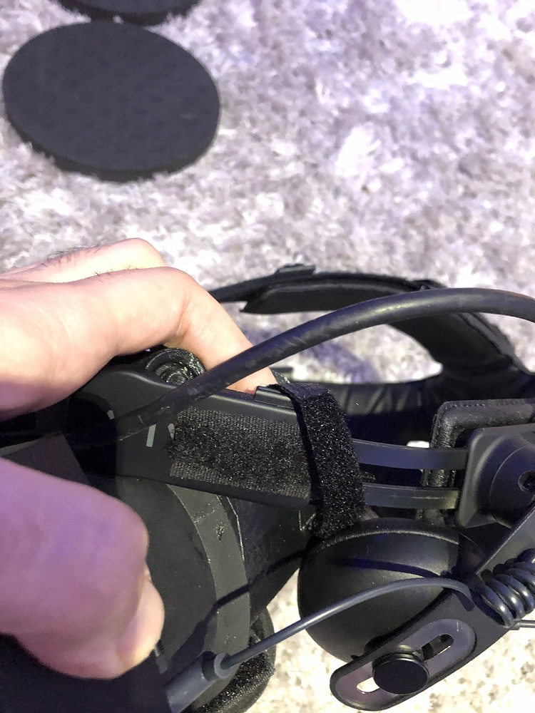

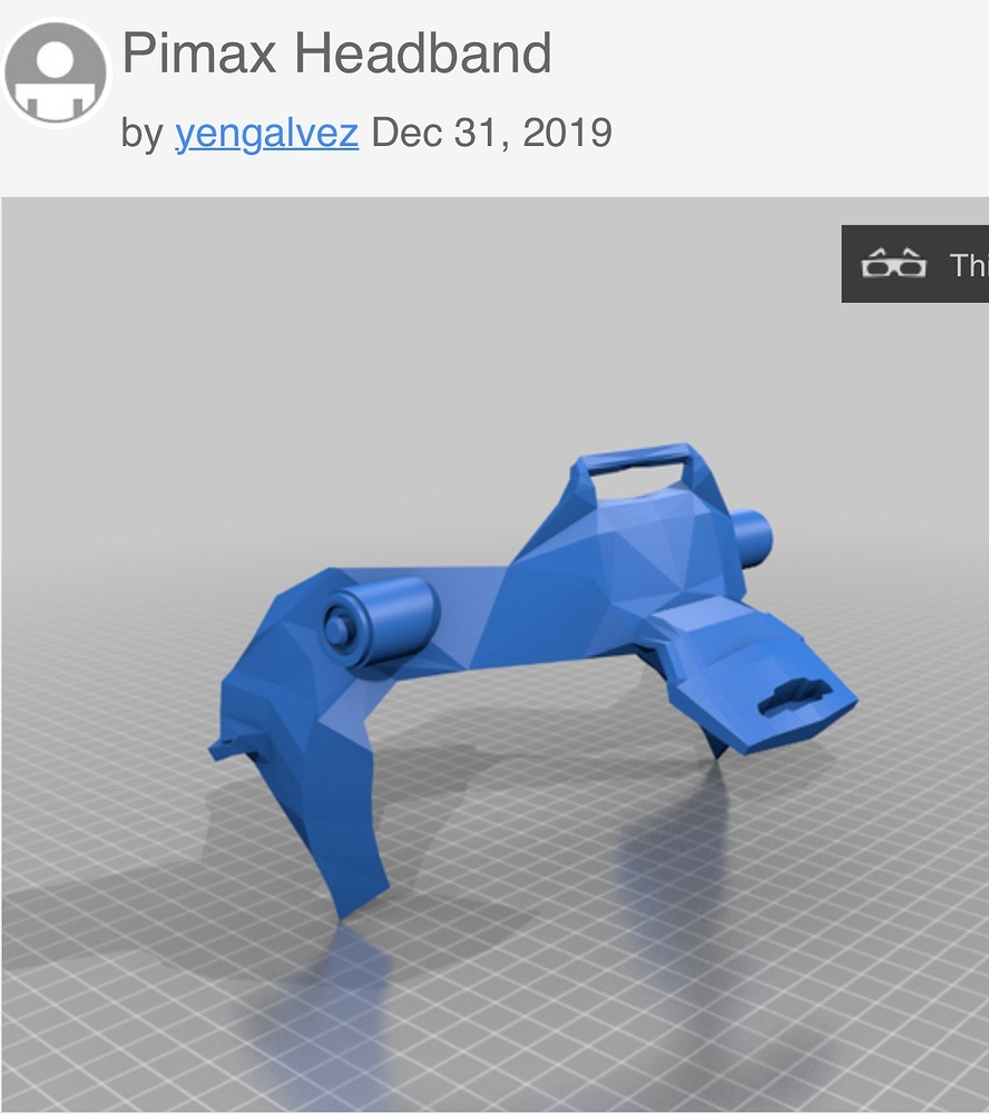

6. Yengalvez - Super DAS Mod - Dec 2019
Finally, I finished my headband mod version. As you can see the weight is on the forehead, and not in the face. It makes that you don’t feel like you wear glasses.
You will need some foam to finish the headband and make it comfortable :slight_smile: See pic above.
This Velcro it’s necessary if you want to attach it to your face as near as possible.
Pimax Headband by yengalvez - Thingiverse

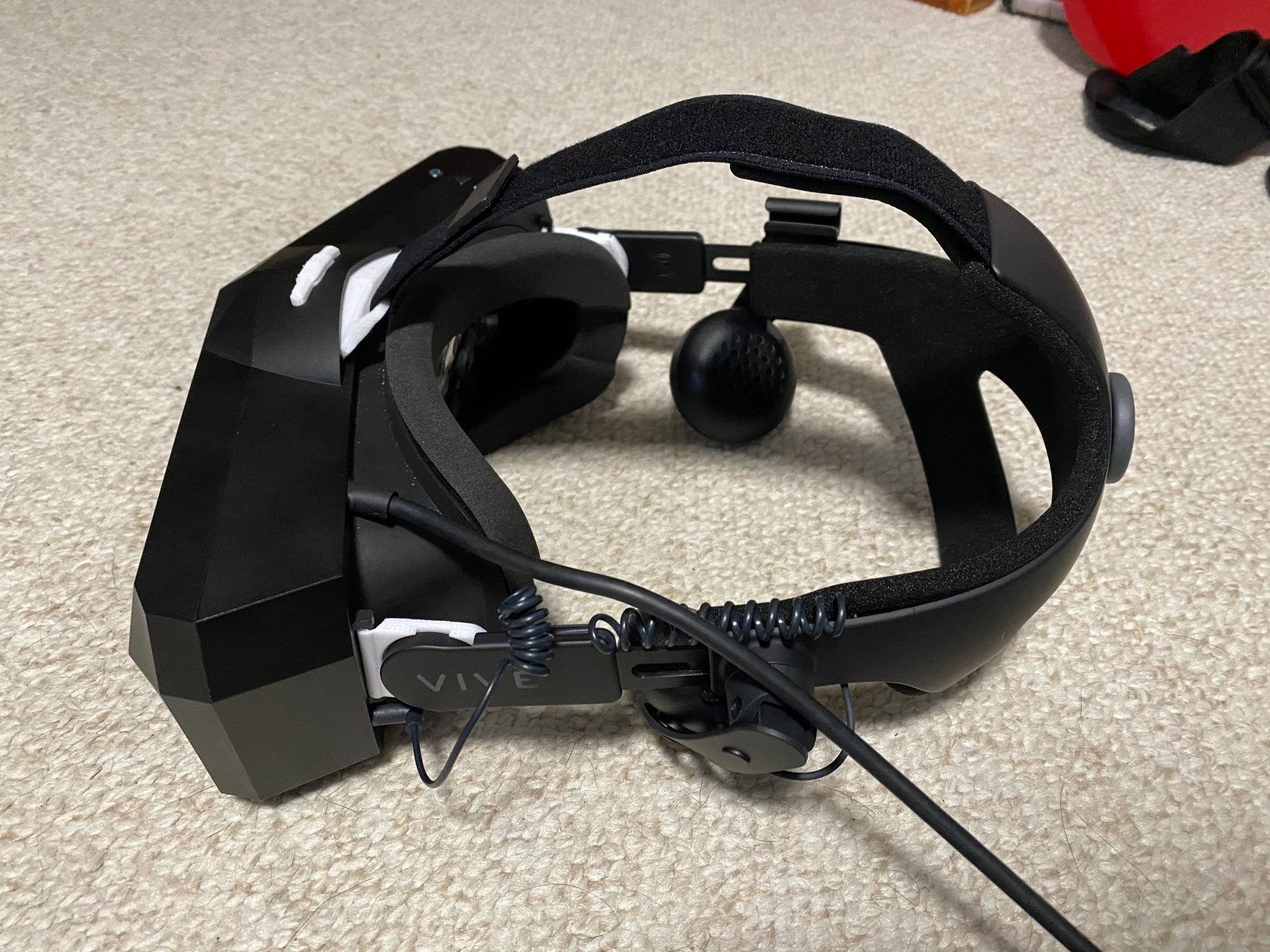

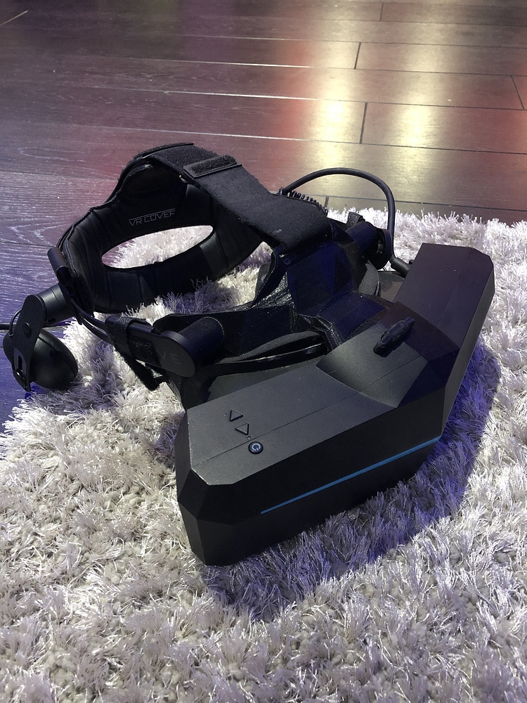

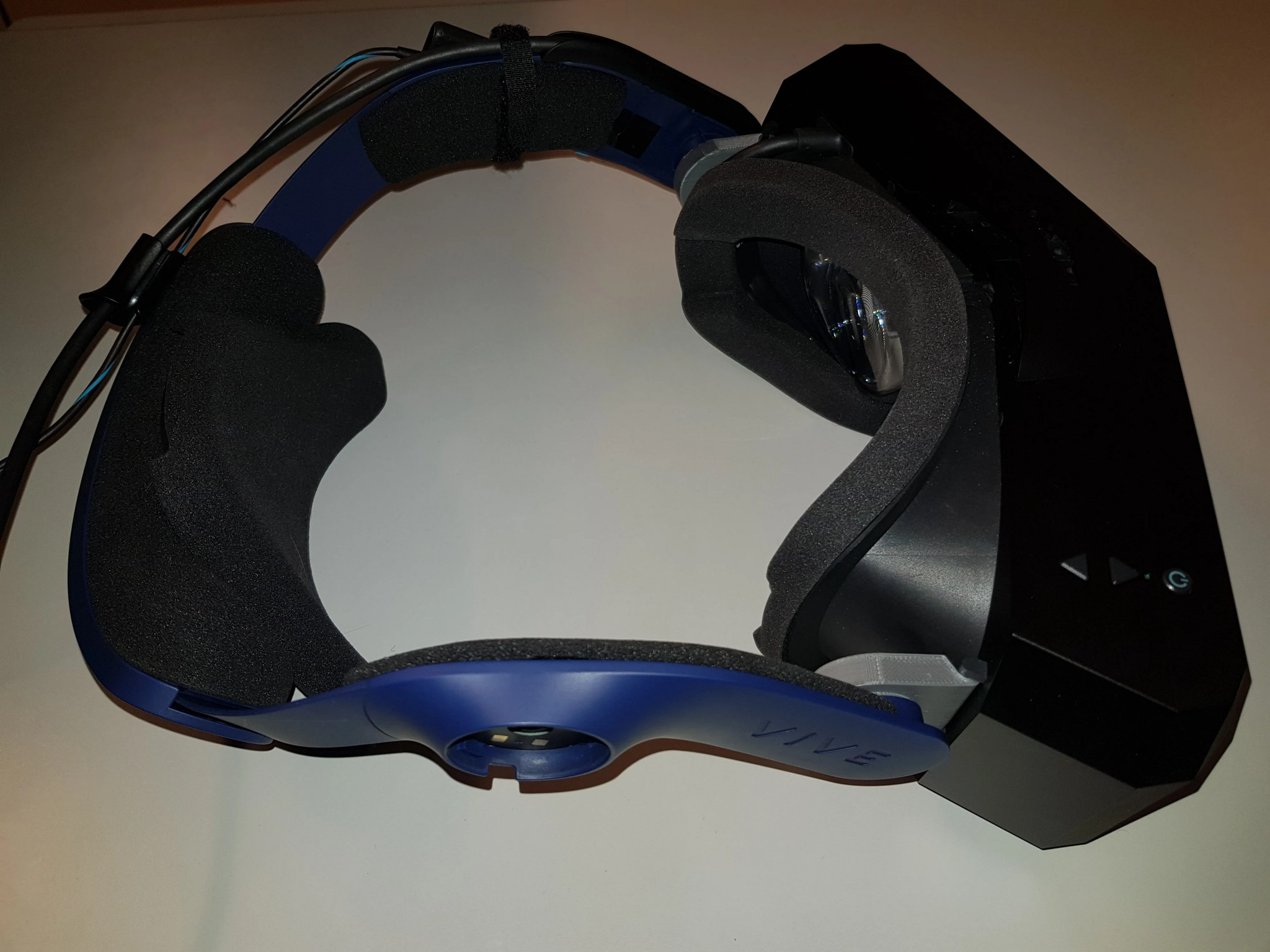

5. Vive Pro Strap Adapter
Date March 2020
By mathias_delahaye
This part is an adapter between the Vive Pro / Vive Pro Eye harness and the Pimax head mounted display
ShawnMayer Print with Koss Headphones
March 2020
I complete my Pimax Artisan with Vive Pro Strap using this adapter and koss ksc75 headset
This is really comfort and koss ksc75 sound is really great.
Vive Pro Strap without Audio $45 :united_states:. Confirm stock before Ordering.
https://www.mobile-part.com/htc-vive-pro-mount-cradle-all-assy-74h03422-10m-p0400.html
Link to Source

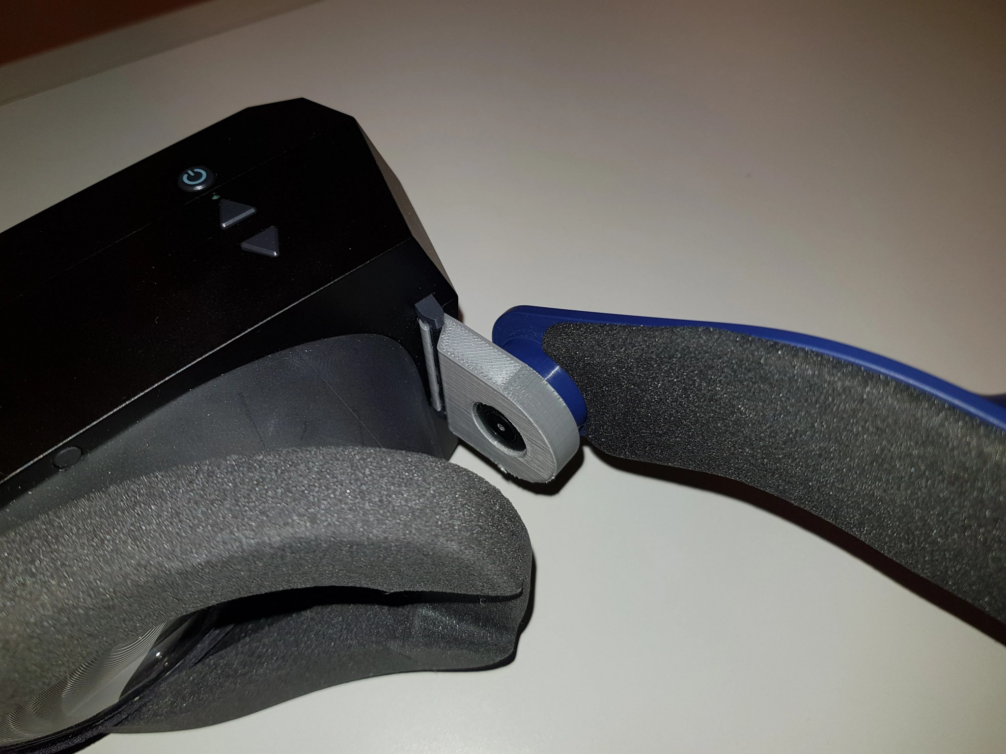

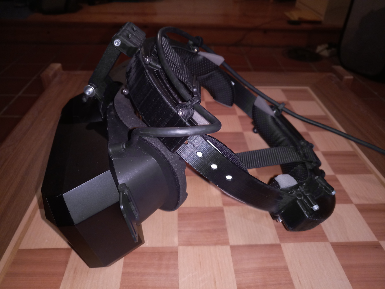

6. PSVR Headstrap Adapter
Date March 2019
By Virtualmisterl
I took a headstrap from a broken psvr & created a headstrap adapter which has at least some adjustment on all axis.
you can move the whole headstrap up & down, you can slide the hmd in & out on the psvr slider & it can also be tilted up & down on the hinge..

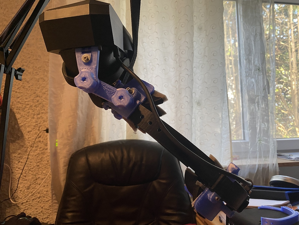

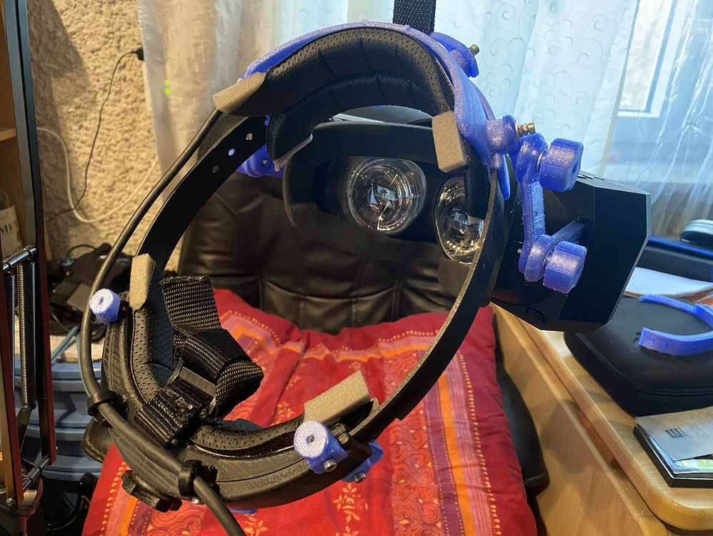

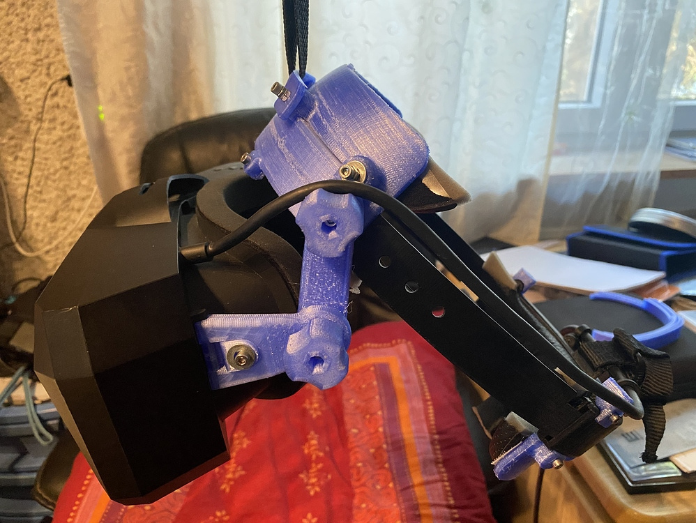

7. Custom Ridgit Headstrap Flip up able
Date Nov 2019
By Nid
Because I had problems with the fit and the weight balance of the standard headstrap, I designed a 3D printable headstrap:
I should mention, that I’m able to flip the HMD up, so I don’t have to take the headset of, when I want to check something on my PC.
V1 Design
V1 had too much Wobble. So V2 attaches from sides.
Onshape
Link to Source
