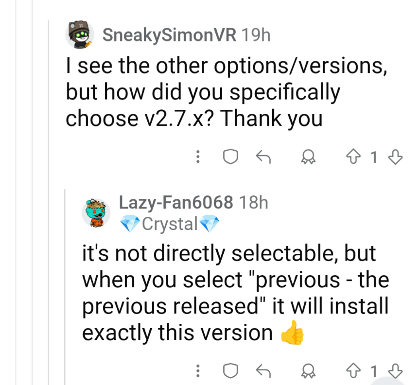

Setting SteamVR to the prevous vertion 2.7.4 has fixed it.
Reactivating SteamVR 2.8.6 broken.
