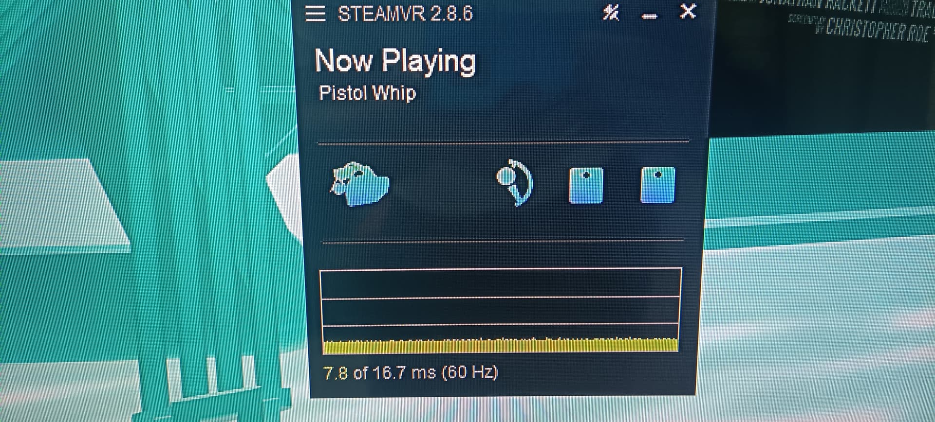

I have removed all overclocks on the CPU and GPU. I have tried 60Hz, 75Hz and 90Hz.
Furthermore, I have this ghosting when I have no performance issues, e.g. hitting 7.8 of 16.7ms (60Hz)
With and without “Hidden Area Mask”.
With and without “Parallel Projection”.
The steam vr view: wobbles.
To recap:
Massive ghosting.
When I open one of the steam overlays, no ghosting. It looks great.
When I close the Steam overly, massive ghosting again.
Massive ghosting:
In both eyes, looks good. When I move my head, I can see where the lines are now and approximately where they were, at the same time. If I hold my head still: the lines then recombine and look good again.
I do think this is a software issue, but I need help?
