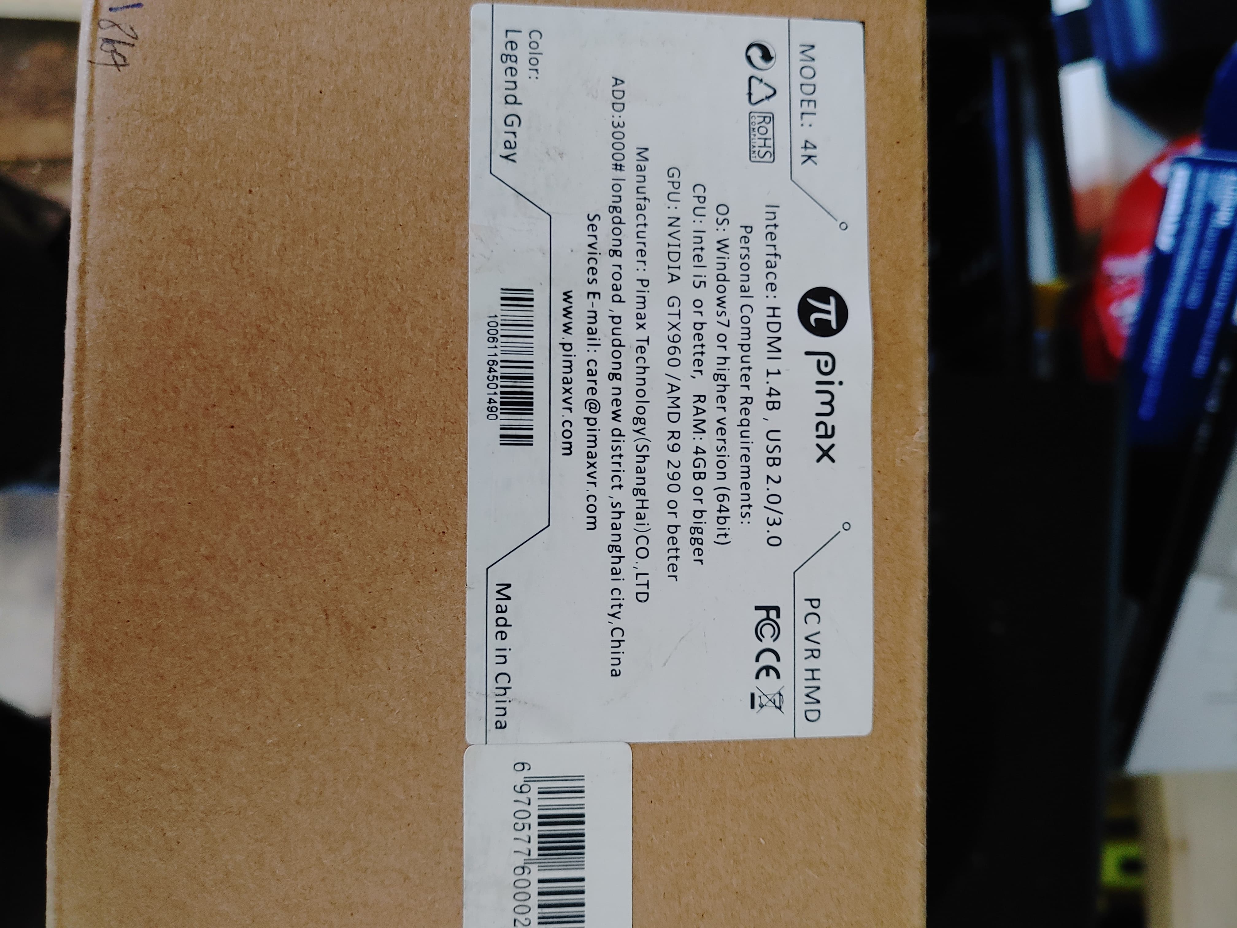

Pimax P1 P4k Retail Box

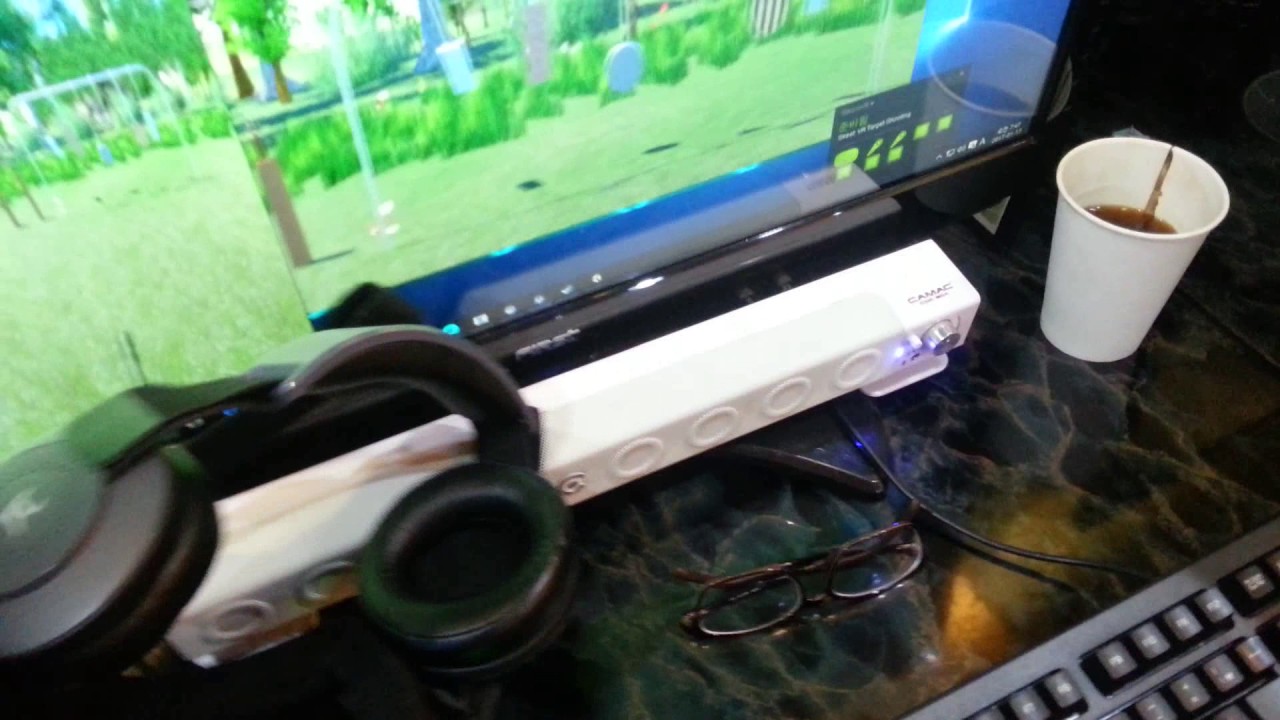

I bought mine with the Optional and quite excellent Audio headphones.

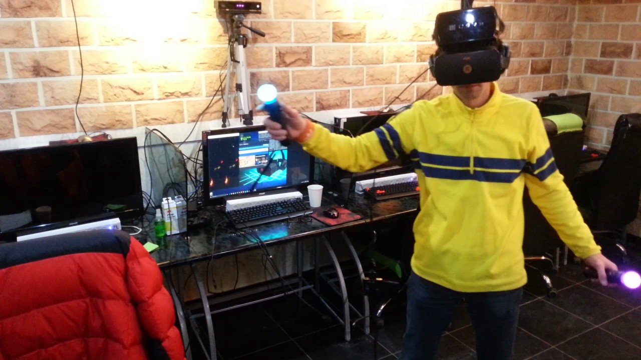

I have completed head tracking using the easiest and cheapest dk1 tracker among the many orientation devices that work with OSVR. I have now completed the project of adding Pimax 4K’s positional tracking and controller via OSVR. I hope that NOLO will provide a simpler installation and satisfaction. But I still believe that Pimax should add their laser tracking system to the Pimax 4K.

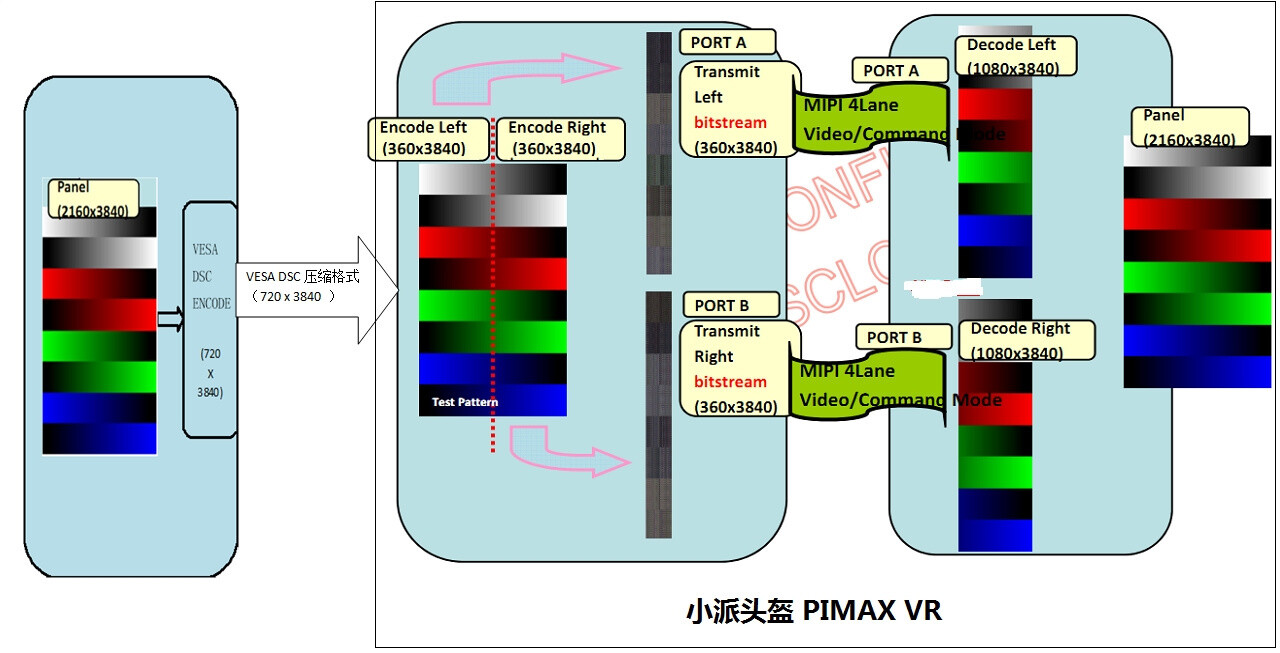

As we all know, Pimax 4K goggle support physical 4K by Interpolation menthod.

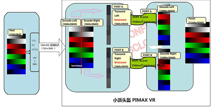

Actually, it also support native 4k resolution by using data compression technology(Qualcomm FBC 2.0 or VESA DSC 1.1), and it works well on android platform. there is the sketch map as follows.
And question arrives, Why not open the native 4k resolution?
The cause is because the graphics card(NVIDIA or AMD)couldn’t support the Qualcomm FBC 2.0 or VESA DSC 1.1 tech. so we have not opened the native 4k resolution until now.
If u are expert on GPU or data compression, please participate in the discussion and try our best to find an valid method to resolve it. thanks.
Sjek had asked how the hmd supported DSC 1.1 to decompress on headset side.
Robin aka PimaxVR response.
@Sjef,
yes, the handset has a special hardware GPU processor which could decode the compressed data within 1ms. all done by hardware.
