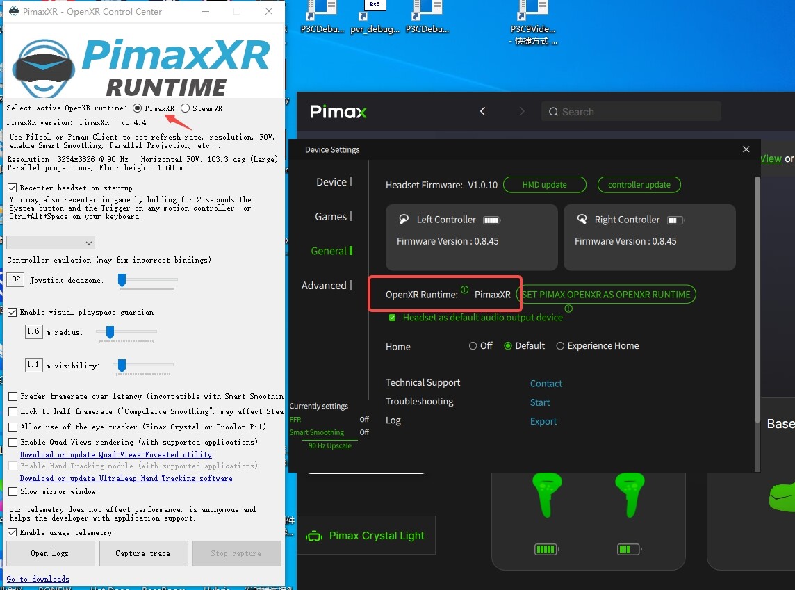

Please check the Pimax Play settings if the runtime is switched to Pimax OXR or PimaxXR.
That worked! Thank you! I am in your debt! HL2 VR definitely does not like Foveated rendering. I’ll have to remember that one.
