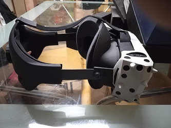

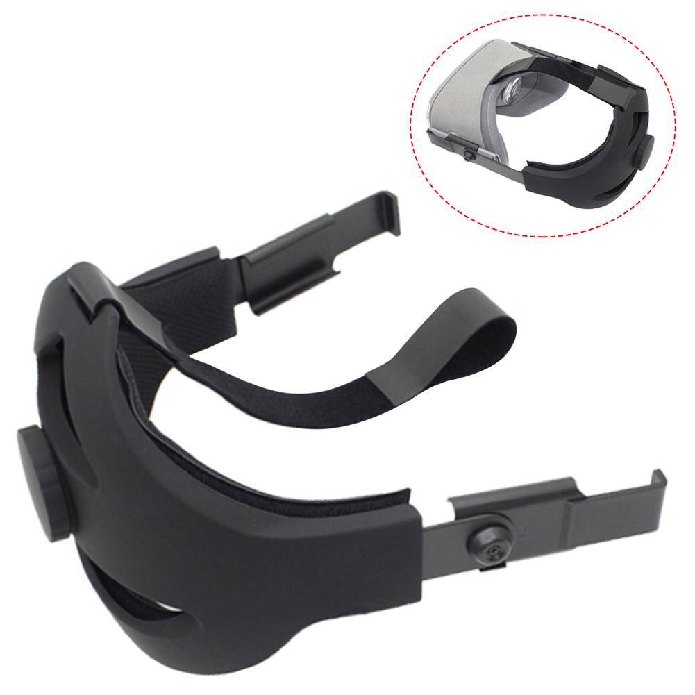

I got this headstrap made for Quest 1 on AliExpress

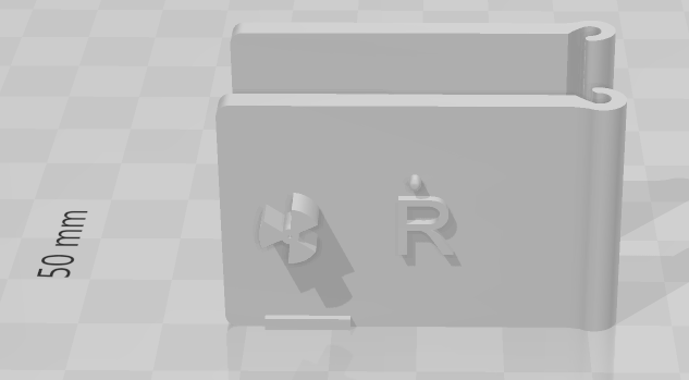

I printed some hinges to make this fit
And it was great, confort is outstanding lol

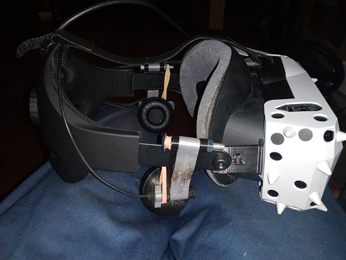

so I had to add it speakers, I used the one I had on my previous Pimax 8k/5K+ headstrap with headphones upgrade by adonfff - Thingiverse
and voila :
As I noted in the post, I used drivers from cheap AE headphones and the sound is amazing, if the DAS as a 7/10, KDMAS a 7,5/10 (because of huge bass) this one is 10/10…hardly can be better.
Rubber bands are for maintaining pressure on the ears.
