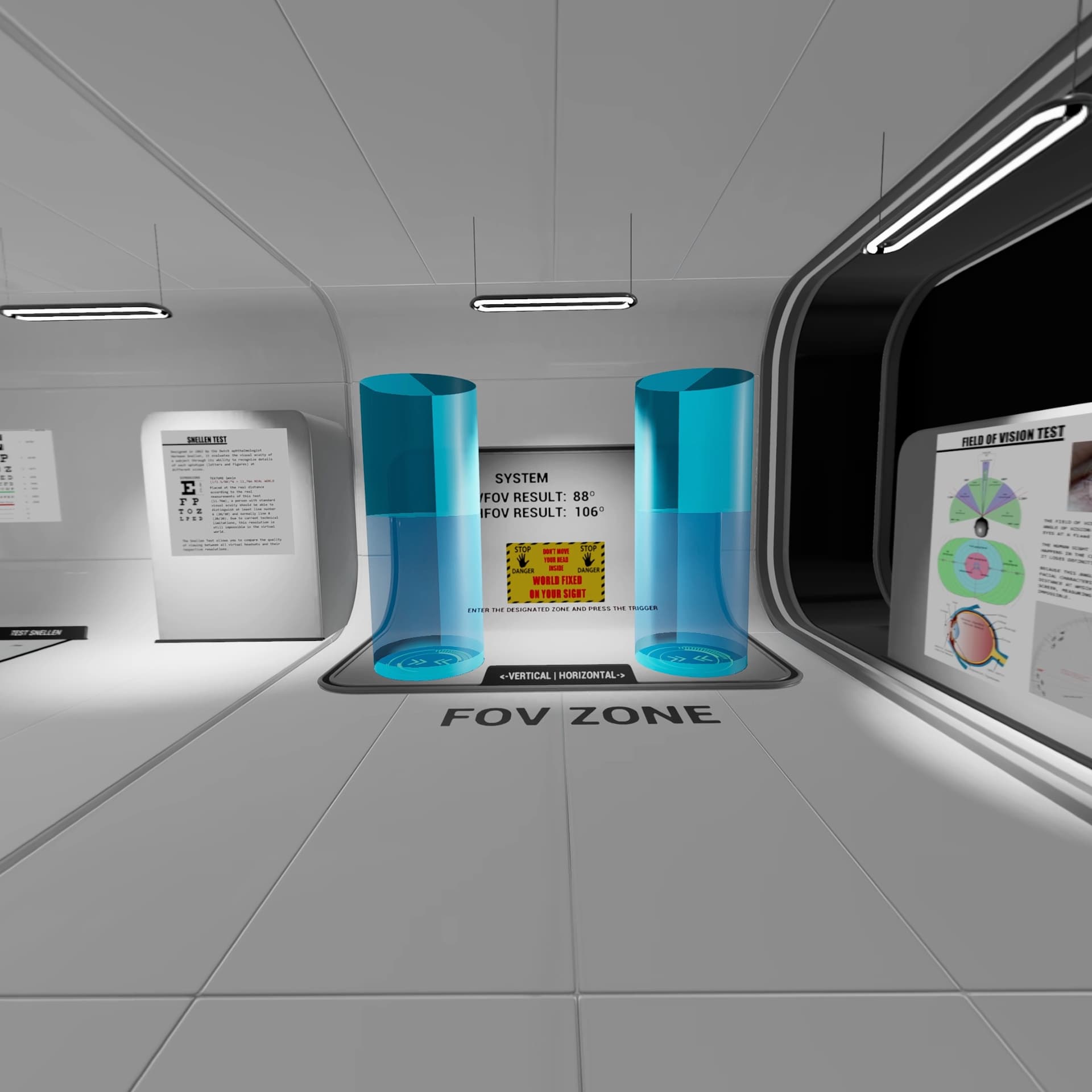

Visuals (tested using the ROV tool):
| Column 1 | Pico4 | Quest3 |
| FOV | Horizontal - 99°, Vertical - 89° | Horizontal - 106°, Vertical - 88° |

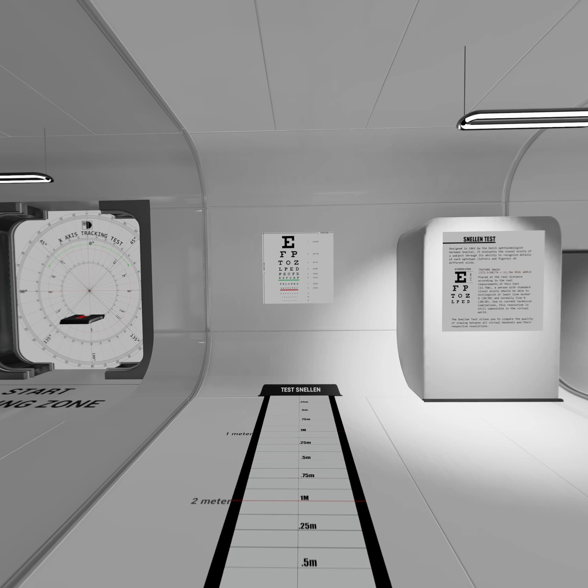

| Snellen Chart readability @ 4 metres | Line 7 (almost line 8) | Line 7 (barely) |

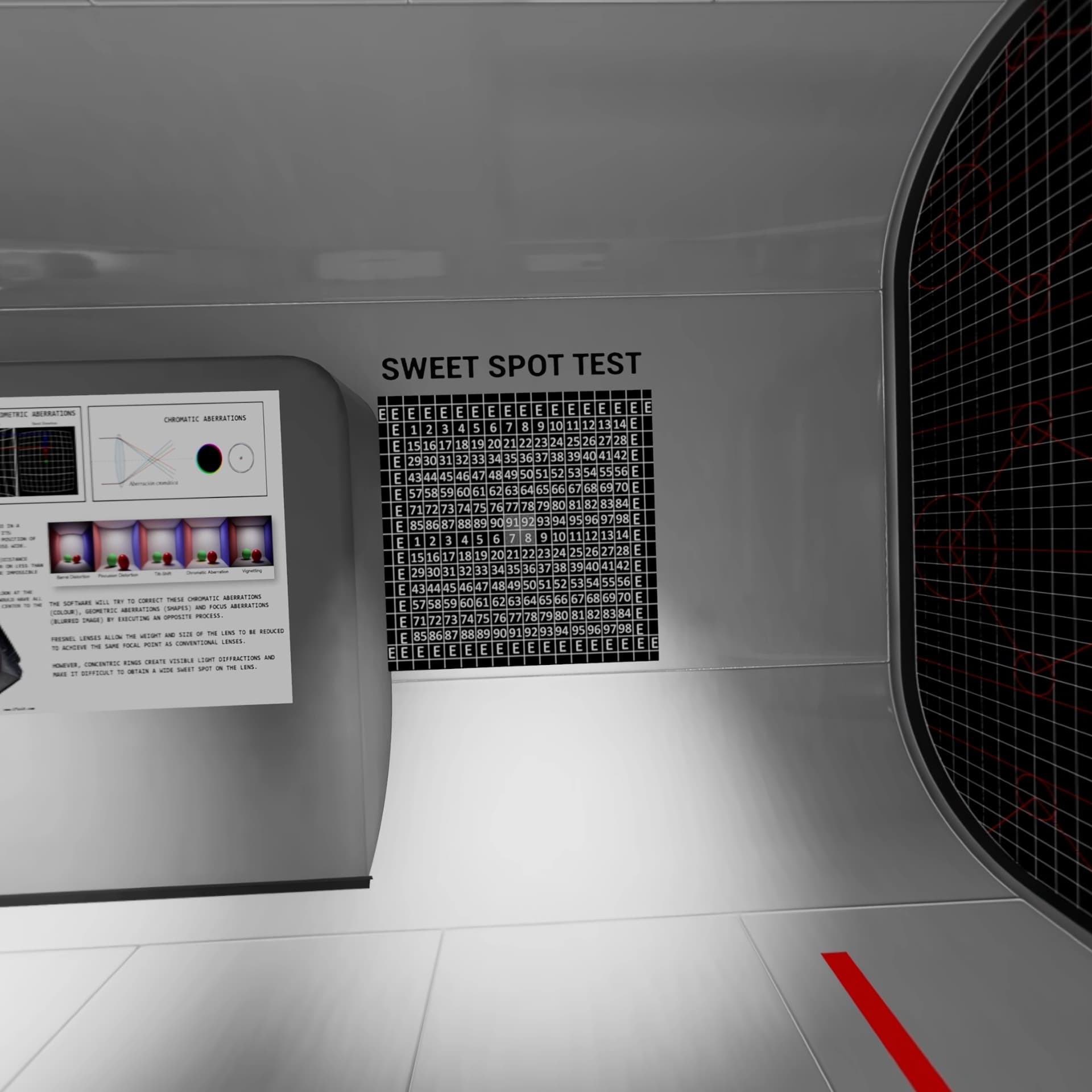

| Sweet Spot | 40% of visible area | 99% edge to edge clarity |
| Binocular Overlap | 75% | 50% |

I didn’t notice much difference in FOV, but Quest3 came out ahead when measured using the ROV tool.
The Pico4 higher resolution screen does make a difference in text readability, but it is not significantly better in-game.
The Quest3 has an amazing sweet spot - essentially the entire FOV is sharp. Not so with the Pico4, despite also having pancake lenses.
I useed the ROV Sweetspot test screen to also estimate binocular overlap. Pico4 has a significantly higher binocular overlap; 75% vs 50% for the Q3. I didn’t notice anything amiss with the Quest3 though. Perhaps more testing in game environments would show a difference in 3d presence.
