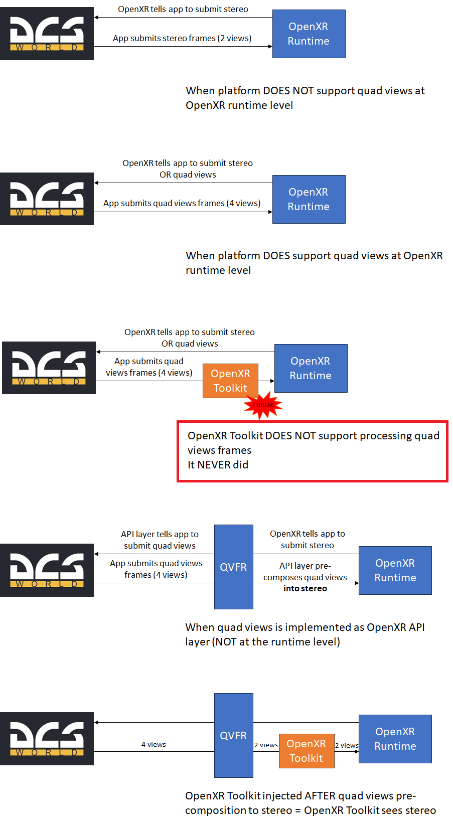

Users are reporting black screens in the headset in DCS (and also Pavlov) unless they are (re)installing the Quad-Views-Foveated mod (aka “QVFR”). On top of that certain misinformed users are making incorrect claims about “bad support” in Pimax’s OpenXR runtime.
I’m going to clarify the situation. If you are experiencing the black screen issue, your problem is 99% likely to be because you have OpenXR Toolkit enabled. I’ll write it loud and clear: OPENXR TOOLKIT NEVER SUPPORTED QUAD VIEWS. It simply doesn’t. This isn’t a Pimax issue, this is true on all platforms. OpenXR Toolkit only supports stereo rendering.
Some will claim they used OpenXR Toolkit in conjunction with quad views before. Yes, they have, but there is a very important nuance to that statement: they used OpenXR Toolkit with Quad-Views-Foveated, which if installed correctly on your system (order of installation), will cause Quad-Views-Foveated to produce stereo output for OpenXR Toolkit. This is why it worked in this scenario.
However, with quad views support implemented directly inside the OpenXR runtime, doing such “intermediate stereo” step is simply NOT possible. You simply cannot interpose OpenXR Toolkit (and other API layers) between the quad-to-stereo composition and the runtime. This is why re-installing Quad-Views-Foveated allows to use OpenXR Toolkit again, because it forces OpenXR Toolkit to run after the quad-to-stereo composition. (Diagrams below for more details)
The proper solution to this issue is rather to uninstall OpenXR Toolkit, an obsolete piece of software that hasn’t been maintained in 2 years.
Here is a series of diagram explaining in details all of the above:
