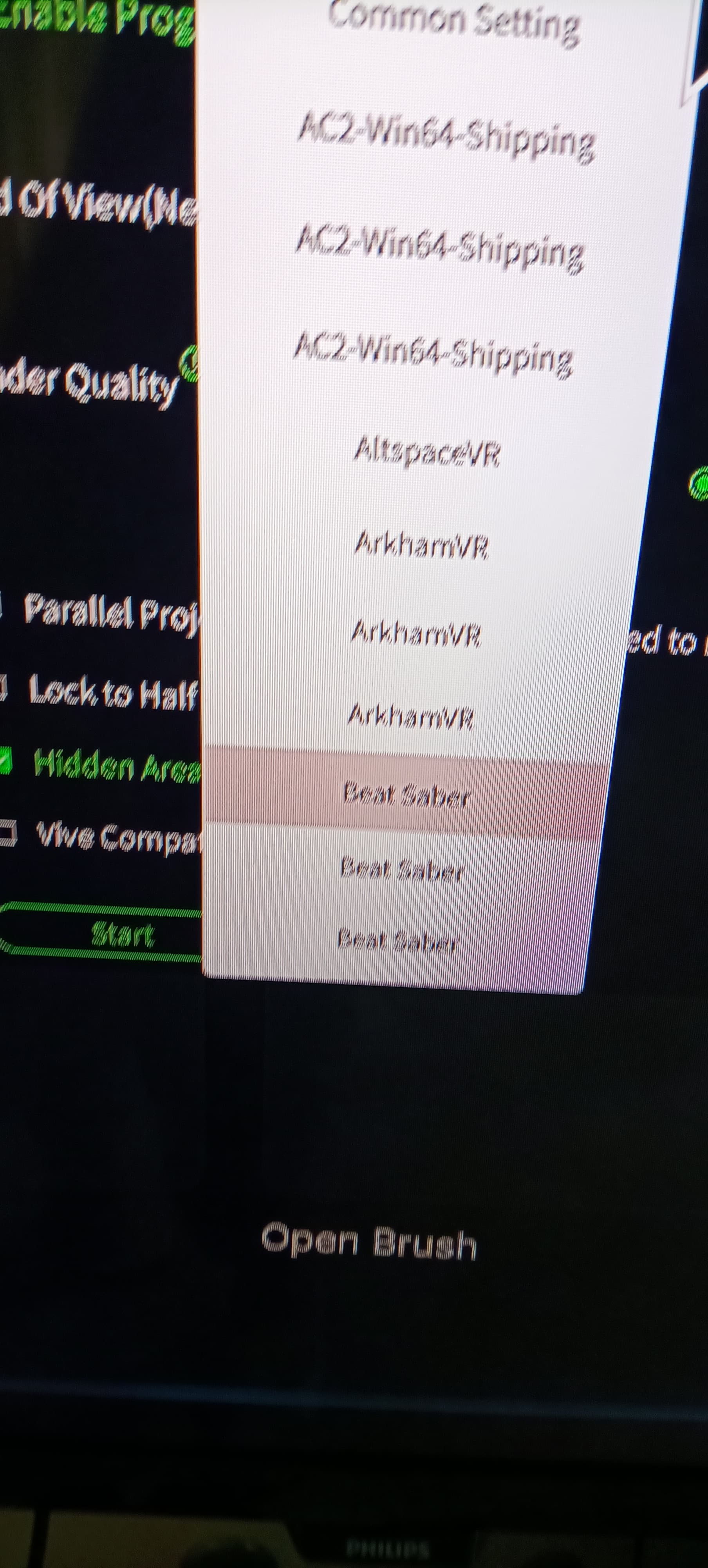

I am having flashing screen problems with my 8Kx (even though I just came back from the factory for a fix).
As would be a standered set of problem-solving tools, I was forced to upgrade (Downgrade) to Piplay v1.30.01. I do see why we should start with the latest firmware and software!
PiPlay v1.30.01 is crap.
Forced to register and log in. I have been registered with pimax for 4 years and their system does not know me. I used my pimax username and password and I did not know me!
Pi play looks like a front end for Pitool: you need to open a new window for access to 8kx settings - and it looks just like pitool.
Now even harder to navigate.
Games listed many times. When I change the setting in one, they all seam to change. No way to delete that (clean it up)!
I can not find a way to start ProjectCars2 with PP. the settings seam to make no difference.

The “Games listed many times” fixed itself on a reboot.
