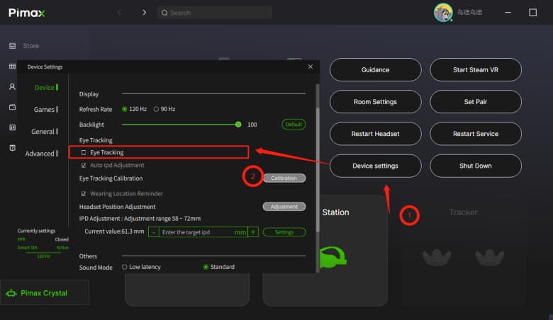

  1. Toggle the eye tracking feature and enable auto-IPD adjustment. When you put on the headset, it should trigger the feature.

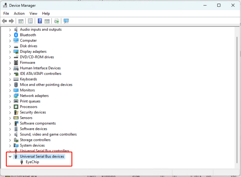

  1. Check Windows Device Manager for the “EyeChip” device. If it’s present, it indicates a successful startup. If not, try restarting or reinstalling Pimax Play.

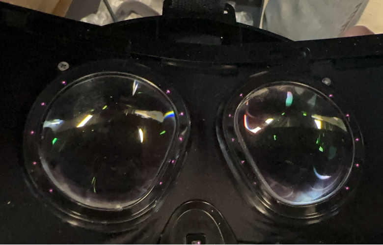

  1. Use a camera to verify if the IR LEDs on the headset light up when pointed towards the lenses. If they don’t, gently reseat the lenses until you hear a “click” sound.
    **Please deactivate the flashlight or refrain from using it while capturing the picture.

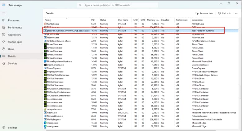

  1. After a proper installation, launching PimaxPlay should start the Tobii eye tracking process, which you can see in the Task Manager. If it doesn’t start, consider completely uninstalling PimaxPlay and then reinstalling it.

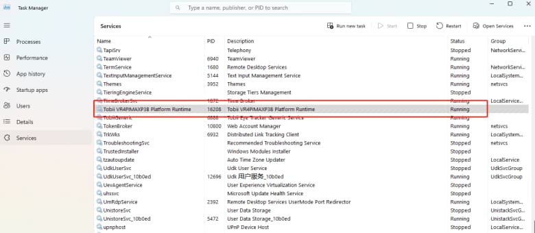

  1. In the Task Manager under Services, check if the Tobii runtime is listed as “running.” If not, manually enable it.

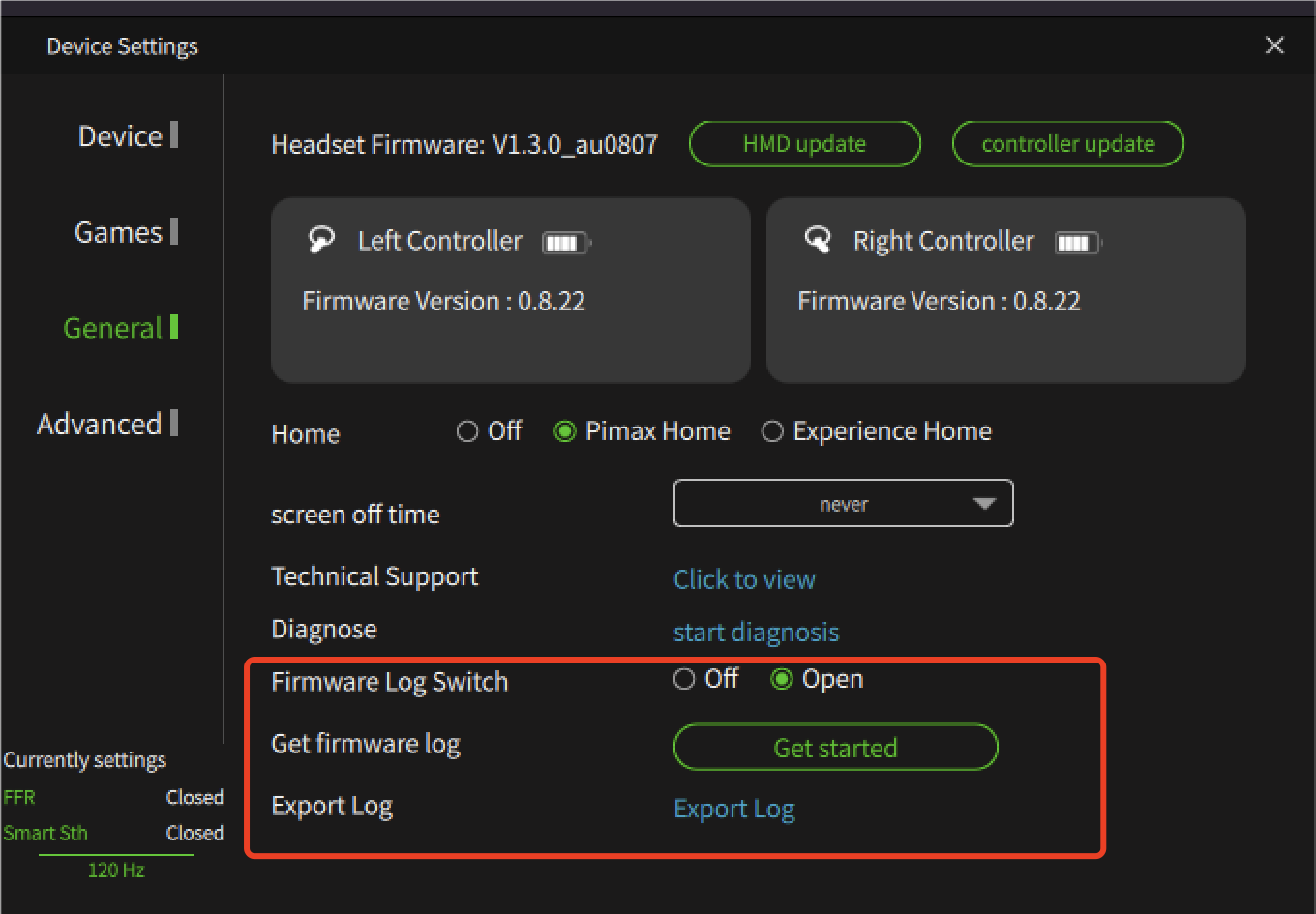

  1. If you’ve followed all these steps and the IR LEDs are still not visible, export a log file and send it to us.
