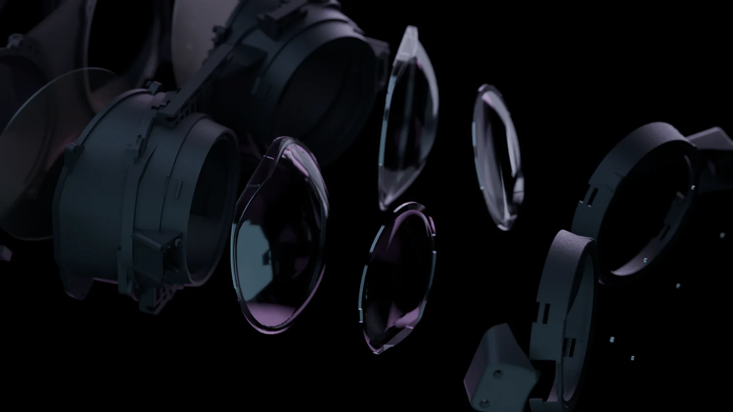

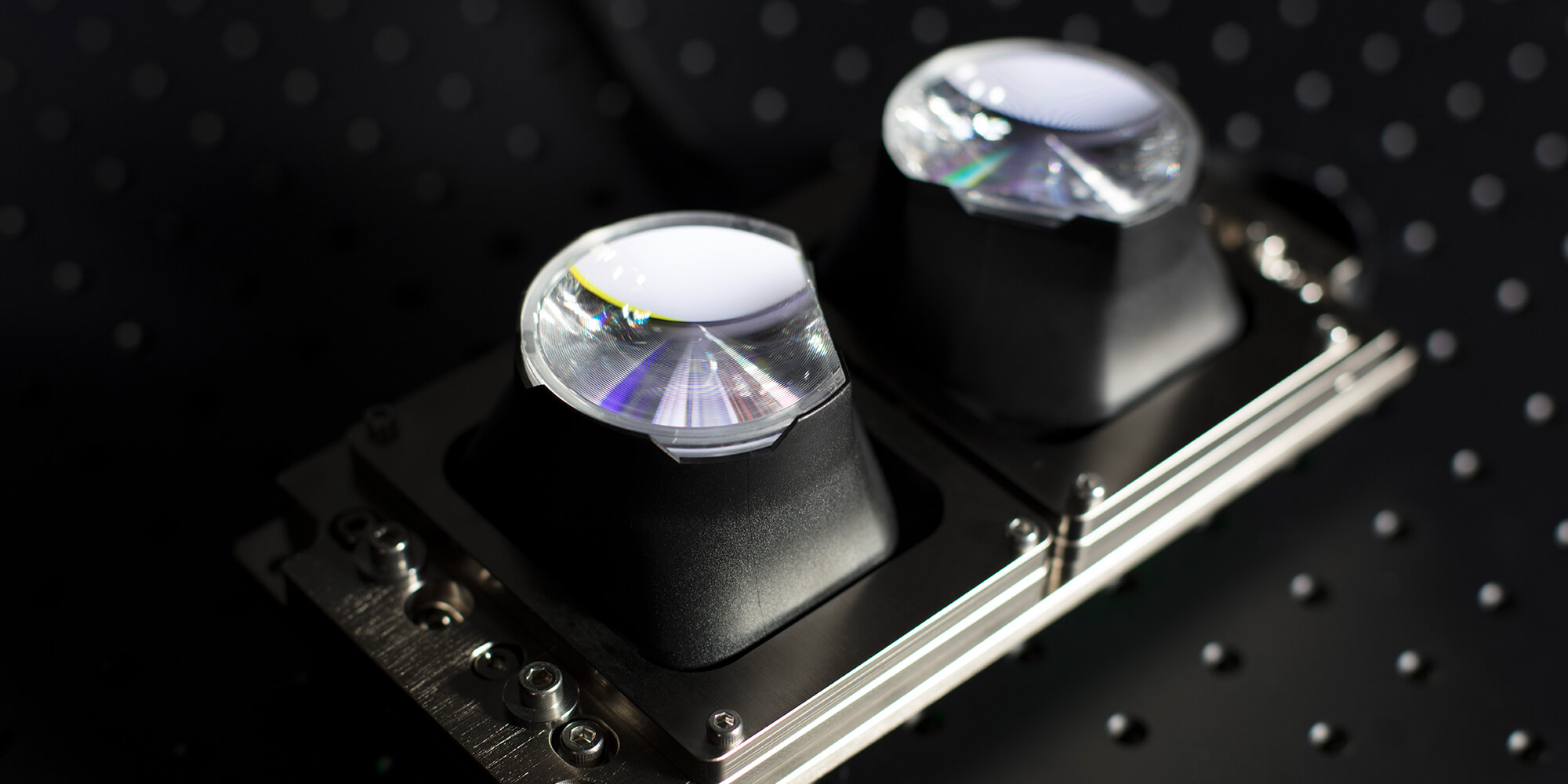

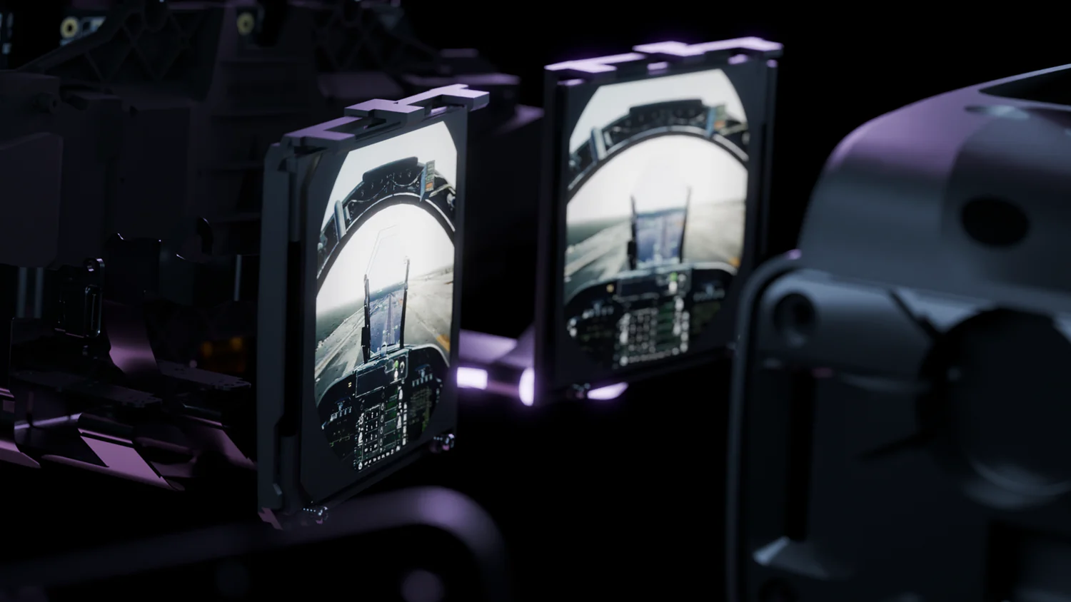

SO I was looking at some exploded views on the VR1. They look to have canted displays. Really hoping I dont get eye strain like on the XTAL and 8KX because I just placed an order. And I was happy to see I figured the exchange rate in pounds instead of euros. I thought it was going to be $3200 but in Euros is was $2715 so that was a nice surprise when I looked at what I was billed in dollars.
How did you find the Ind x? As iirc it has canting of 5°
Besides Pimax I thought the Index was the widest FOV consumer HMD, that being said, I was going to respond about my experience with the Index but I thought of it while I was at work today, haha. The Index was fine, very easy on my eyes. I actually looked at some exploded views of the Index yesterday and it looked like the panels werent canted at all but since it was only 5 degree then maybe it really didnt show in the pic, see pics attached
I enclosed some pics of the VR1. Its hard to tell from the pics of the VR1 but it looks to be canted slightly according to the pic of the panels, but the pic of the lenses looks like it canted quite a bit, could just be the angle of the camera though
